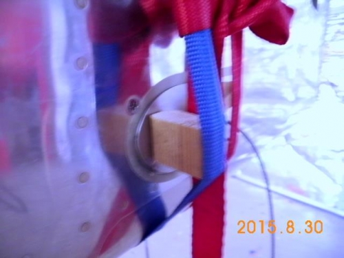

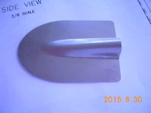

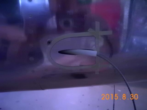

Purchased Rudder Cable Fairing Set #10728 from Aery Tools. Image 1 show how I shaped them in a streamline mannor. I choose to epoxy them on the fuselage for a cleaner look. Image 2 shows the location and taping to reduce epoxy cleanup. Image 3 show how I held them in place while thw epoxy wasa setting.
Layout and Taping
Layout and Taping
Epoxy Setting
Epoxy Setting
