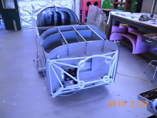

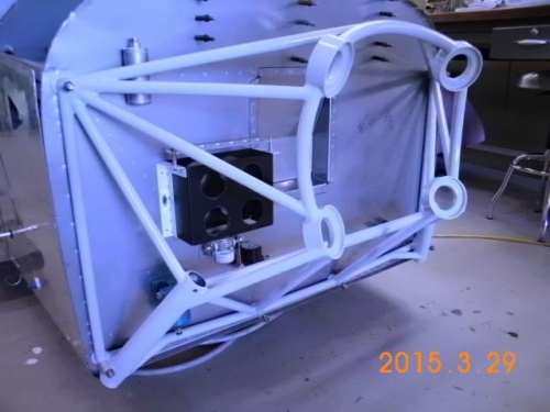

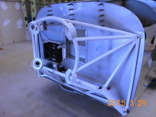

Brief Description:  Installing Engine Mount
I bused a series of nylon and brass bushings to incremently increase the bit size as I drilled each hole.To keep the bit centered I used up to three 1" long bushings together, inserting into the mount bolt hole as guides. Engine mount sides on and off with relative ease. Filed flanges of side and bottom skins, and firewsll flages to 1/8th clearness around gear legs.
