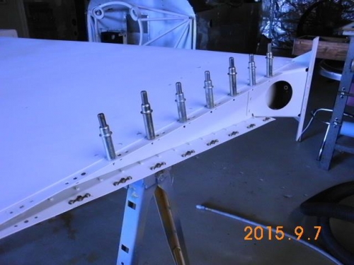

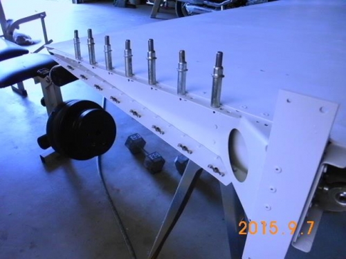

I decided to install K1000-06 nutplates instead of fastening the lower fairing tip with CS-4-4 blind rivets. Doing this will allow access to the wiring connections and Nav/strobe light fixture in the future.
