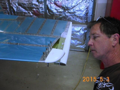

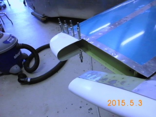

Worked on fitting the horizontal stablizer fiberglass tips. First I had to trim away excess material from both the elevator and the stablizer tips to get them to pass each other.This was very time consuming to install mark remove and install again, over and over so as not to cut to much away.Only about 1/8" of clearance currently, will open this up when closing in the tips.
Left stablizer
Left stablizer
Left stablizer
Left stablizer
