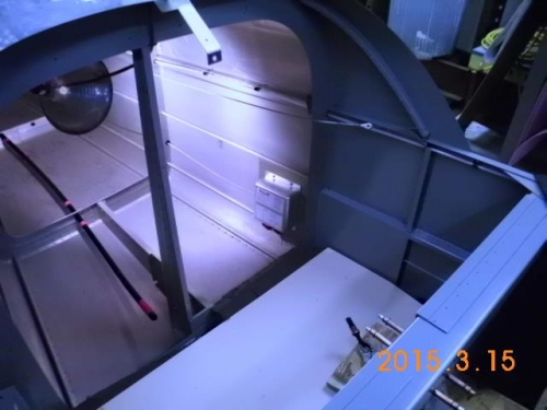

Brief Description:  ELT and Strobe Generator Bracket Relocation
I originally had these brackets installed on the upper stringer. However, it was suggested that I install my magnetometer in the fuselage so I deterrmined that the original location of these brackets might cause some interfearence so I lowered them to the stringer below.

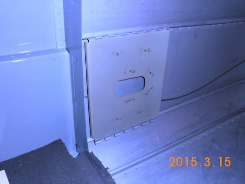

ELT Bracket w/hinges installed for ADS-B bracket

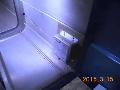

Strobe Generator
Strobe Generator
