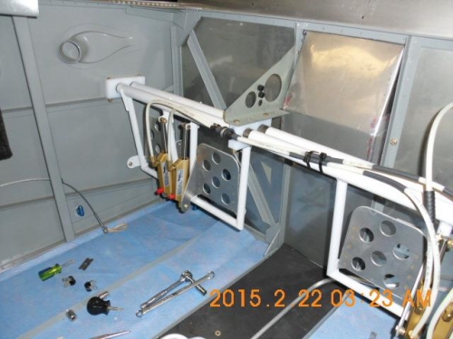

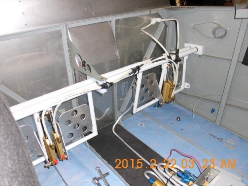

Using Van's Dual Brake Overhead Assembly kit 3.1.11 I reinstalled the Rudder pedal assemblies, bearing blocks and checked clearances. Then I fitted the master cylinders and plumed them in with the PT-062x1/4 nylon tubing from Van's. I rerouted the tubing many times before deciding to route the tubing forward of the pedals and used an MS21919DG8 Clamp to hold in place. To help secure the cllamp, I removed the spacer washer between the center bearing block and put the clamp in its place. I used heat shrink and some 1/4" fuel line hose to ensure no chaffing.
Show routing of tubing forward of pedal assembly
Brake tube Routing and secured to pedal assembly
Completed and tested for proper clearances.
