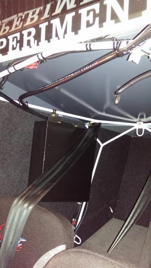

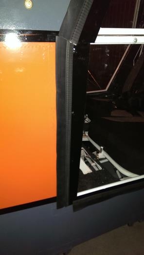

Since the plane moved to the hangar I have made a few trips out to finish off some final details and do a little fast taxiing. I go the fuel lines installed, put weatherstripping around the doors, finished the weight and balance and started fine tuning my prop pitch.

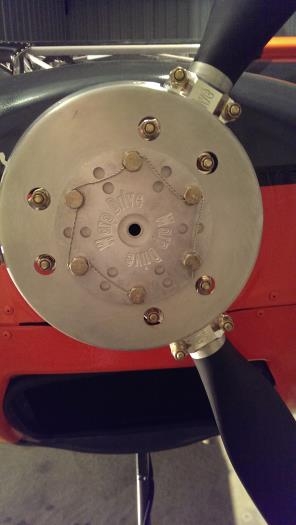

In order to fine tune the prop I got to do a little fast taxiing...very exciting! The propeller needs to be set so that at full power while doing a run up the engine pulls about 5000 rpm. This should equate to a full power rpm setting of nearly 5800 rpm at speed. To hit the sweet spot I pitched the prop to 10 degrees and safety wired it.

Safety Wire on Prop
Safety Wire on Prop
Weather Stripping
Weather Stripping
Fuel lines
Fuel lines
