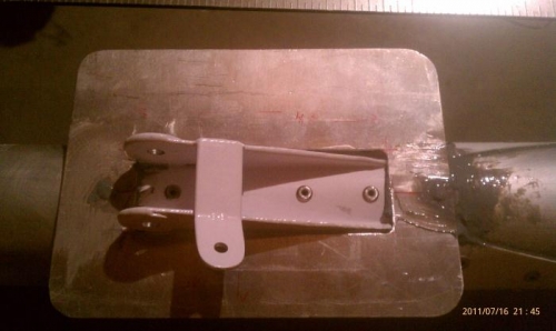

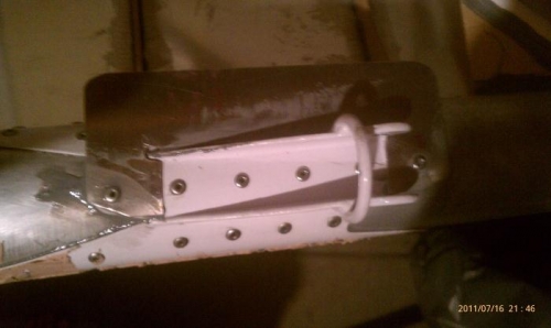

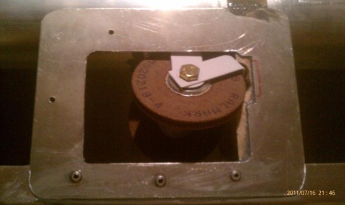

Made and mounted the wing fabric plates. These plates will provide a secure place around the pulleys and lift strut brackets for the fabric to adhere to.
