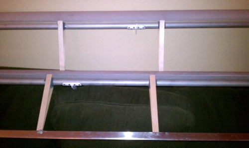

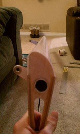

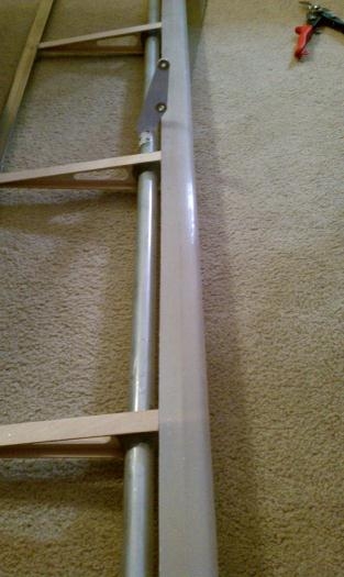

Brief Description:  Fitted leading edge to ailerons/flaps
Fit a fiberglass leading edge to the passenger side flap and aileron. The leading edge is initially too large so it must be trimmed to fit. First it needs to fit around the hinges/bellcranks then it has to be trimmed to fit snuggly against the ribs. Next entry I'll have to glue supports into each leading edge and secure it to the flap/aileron
Looking down a flap
Looking down a flap
Leading edge fitted to the flap
Flap and aileron leading edge
