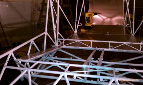

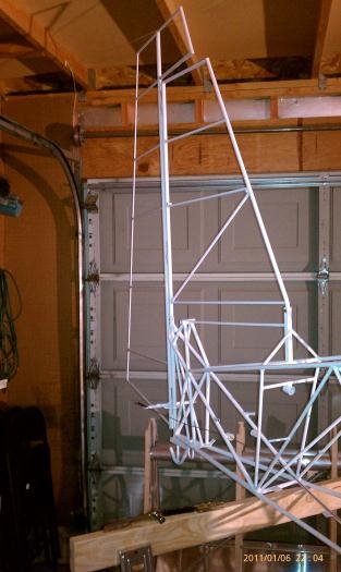

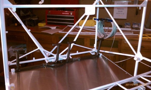

Worked on the rudder
Reamed the hinges for the rudder and hung it to the fuselage. Trimmed the rudder stop to allow 30 degrees of swing each way. Installed the rudder pedal tubes, cable fairings, nylon cable tubes and one rudder cable.
