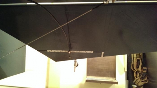

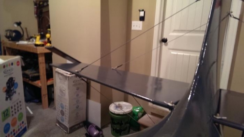

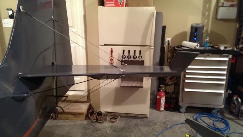

Brief Description:  Elevator / Rudder / Stabilizer / Trim assembly
The title says it all, the final assembly of the tail feathers. Be sure to use grease on the hinge pins. I was also able to get the stabilizers level with the headrack and within 0.1 degrees of level all the way around by adjusting the wires holding it up.
