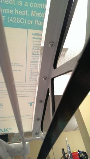

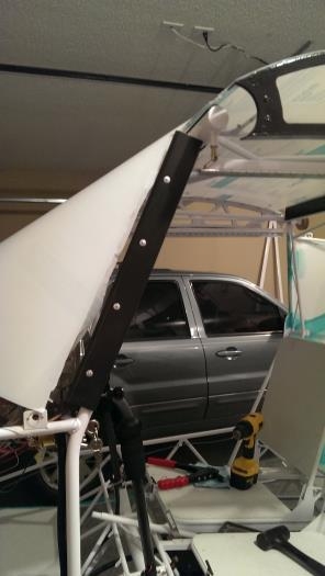

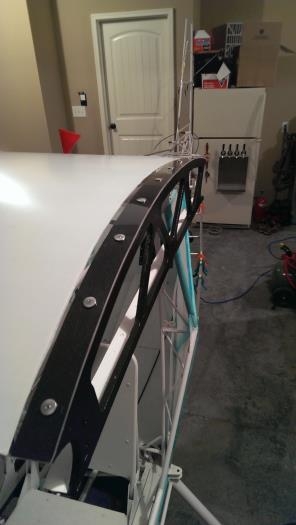

Installed the windshield and windshield brackets today. On the butt ribs rivet washers were used to spread the load, everywhere else rivets were used with no washers - this was mainly due to not being able to reach the back of the rivets.
