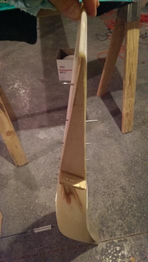

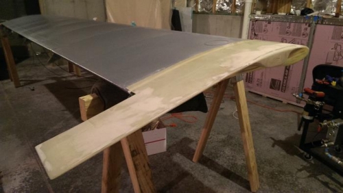

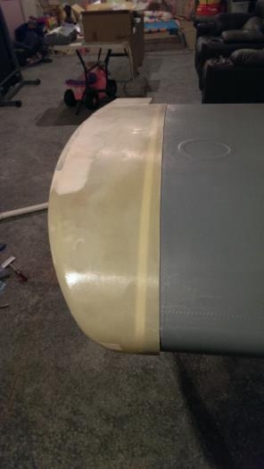

Filled all the scratches and bumps with bondo and sanded smooth. Next the open parts of the wingtip were fitted with 3/8" wood and glued in place. On final fitting all the holes were drilled and tapped so it could be removed.
