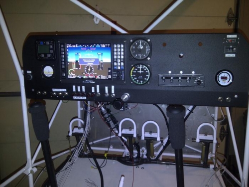

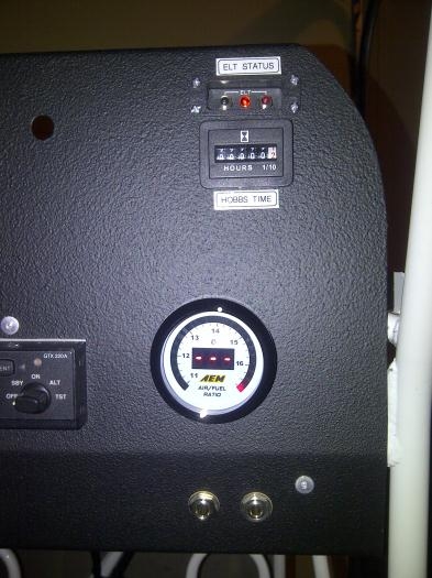

Brief Description:  Wideband O2 Sensor Install
Installed a wideband O2 sensor. This sensor monitors the air/fuel ratio of the engine and can quickly let me know if anything is wrong. To install all that needed to be done was to drill a hole in the panel for the instrument, wire up a 12V, ground, and run the rest of the wiring down to the sensor itself. The sensor mounts in a special bung on the exhaust.
Close up of the gauge
Panel layout so far
Panel layout so far
