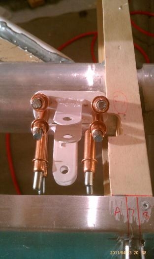

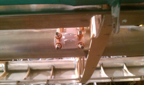

Brief Description:  Aileron Pulleys
Worked on the aileron pulley brackets today. First I drilled four holes in each of the six brackets then deburred everything. Next I had to strip the paint from all mating surfaces in preparation for epoxy. I then fitted both pulley brackets in the correct locations on the spar and drilled holes for mounting everything. Glue and rivetting will likely come tomorrow.
