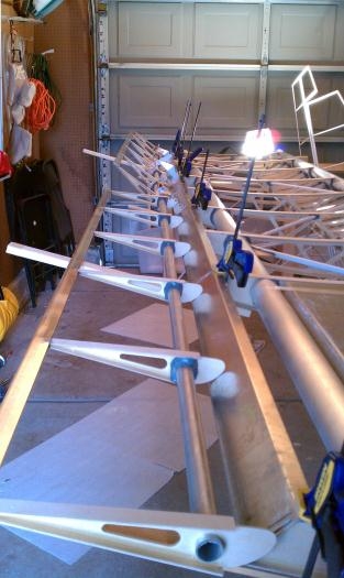

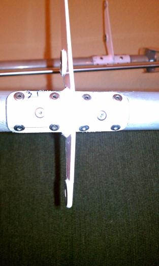

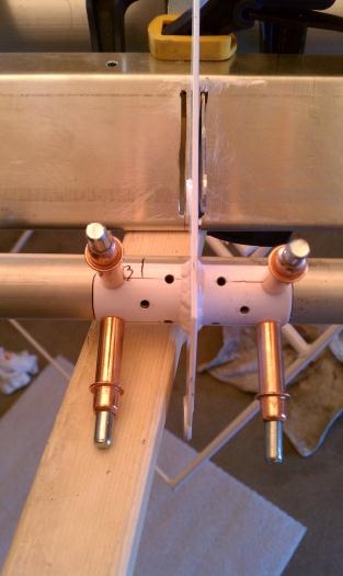

Attached the flap and aileron to the passenger side wing. Each flap and aileron had to be lined up properly and measured to ensure the correct alignment. Each hinge/bellcrank was secured to the flap or aileron with a hose clap then drilled and rivetted on.
Flaps/Ailerons fitted to wing
Drilling attachment holes
Rivetted
Rivetted
