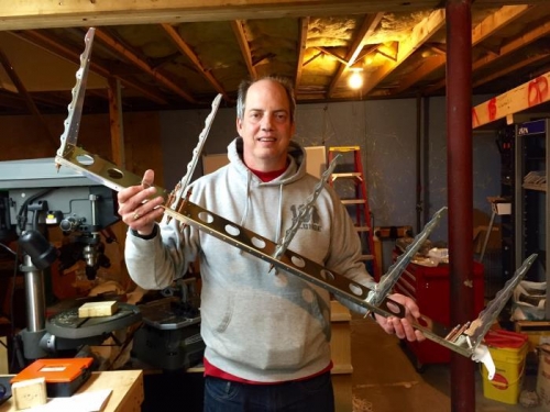

We had finished bulding the rudder skeleton before I took a trip to see my parents in Florida. Upon return, it was time to disassemble the rudder skeleton, because we can't rivet it - because we can't prime it - because it's too cold.

Happier times, building the rudder
