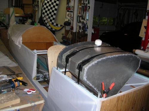

Brief Description:  Covering - Fuse Rt side
The right side fabric was measured, cut and applied. Then measured and cut the fabric for the Turtle Deck and (in the shots below) draped it over the framing. I also then set inplace the center ( between the cockpits) decking and the forward upper decking to get prospective for these shots. I now need to completely seal, shrink then tape the surfaces that have contact with the frame members as well as apply the turtle deck fabric. It will then get a full cross-coat of Ecko Fill by brush. There is a lot of "detail" fabric fitting and sealing to be done before the Ecko Fill is applied.
Fuse Covered on the right side with fabic draped over the turtle deck

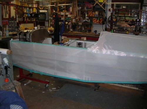

Fuse covered, turtle deck draped

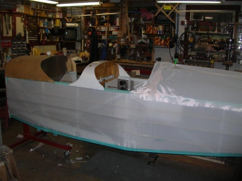

Same shot with the top fuse covering inplace between the cockpits and the front top surface in place.
