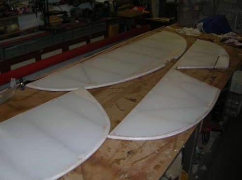

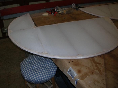

Back to the building....I covered the Rudder with Poly Fiber following their instructions to-the-letter and took it and the ready-to-cover frames for the Stab and El to my AP-IA for inspection. He was totally satisfied with the "factory built" frames and my varnish/sealing efforts. He was also very satisfied with my covering tech. and efforts and cleared me to continue to do just these 3 pieces. I now have to "rib-stich" all three and then add the tapes over top of each rib and all leading and trailing edges to complete the covering of them. I'll then (after he again inspects them) Poly Brush them and then remount the hinges to all three and also re-install the Strut Tube attachment angles to the Stab. These will be the only parts I intend to cover with the Poly Fiber System. The chemical are too caustic for my taste. I'm switching to Stewart Systems material from this point forward.
Stab, El and just a part of the Rudder show with the Fabric-only - installed
Shot of the Rudder with Fabric - only -Installed
