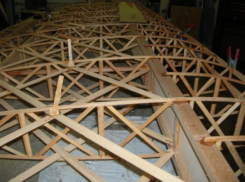

Moved back to the Left Top Wing on the Bench. Continuted to install Geo's on top and bottom. This requires easy fitting then glueing, clamping and waiting for the glue to set over-nite. There is a limit of how much and how far one can go in a single day. This entry is a composite of 4 days effor and results. The Geo strips on top and bottom are now in place and glued. Some early work on the Aileron of this Wing is also started. There are a large numbe of parts to add to the Aileron to complete it before cutting it out of the wing and treating it as an independent functioning part. They have only begun at this stage of construction.
Left Top Wing Vertical geo braces is place

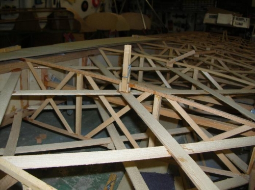

Same issue - longer view

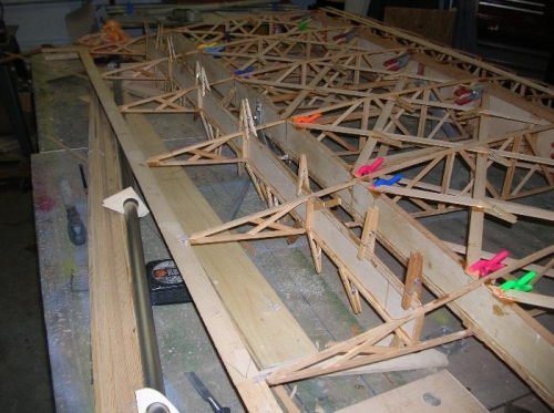

Aileron Spar Web installed
