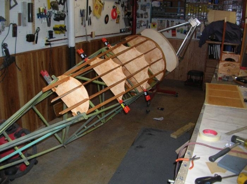

Brief Description:  Rotate Stand for Fuselage

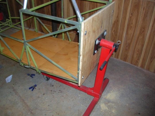

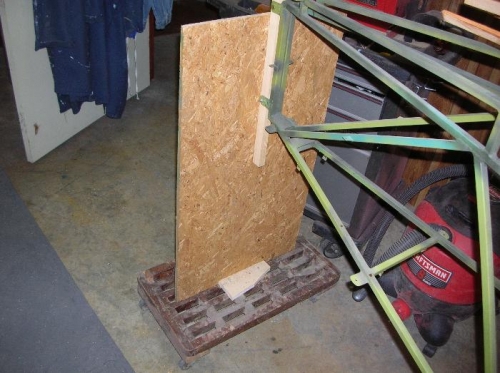

Today was a lot of effort at details left to do from previous two weeks. They take time and are too minor to mention by item but are necessary. The only real accomplishment I achieved was to modify my Engine Rotating Build Stand to act as the front pivot, attached to a temp firewall - and - a very simple and inexpensive rear mount. With these two in place I can rotate the Fuse 360 degrees to continue work on it. (for full rotation I had to take off the Landing Gear Tubes and would also need to remove the Cabanes...I'll do the last part at a later time.
I also gave all of the wood I've fitted to the Fuse - so far - a coat of Urethane Varnish. I also cut in the holes in the top of the Instrument panel module between the front and rear Compartment for the Cabane tubes. I'll also need to cut in similar holes in the front when I install the front panel, gas tank, firewall and 3/32" Ply top cover.
Not a big day in accomplishment but progess.
Fuse turned on it's Axis
Rear Support/rotate attachment
Front Support/Rotate Stand
