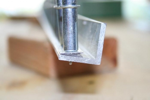

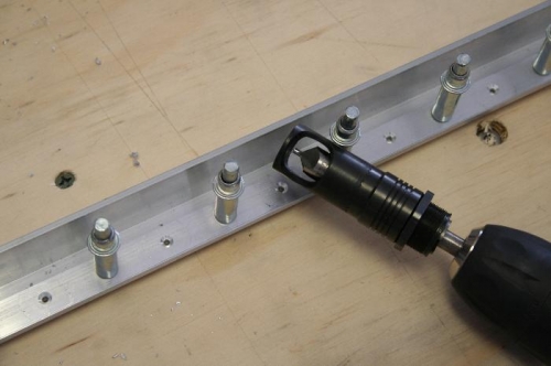

Received the new AEX wedge for the rudder trailing edge. Used angle aluminumn from Home Depot and using the AEX wedge as a pattern, drilled holes through the angle aluminum. The purpose was 2 fold, First these holes became the pilot holes for countersink drilling the AEX wedge and Second I used this angle to clecoe and hold straight the trailing edge after installing the AEX wedge with the fuel tank sealant.
Mixed the Fuel Tank sealant according to the instructions and applied the sealant to both sides of the AEX wedge.

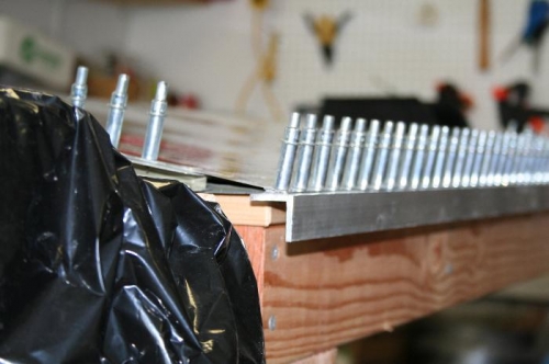

Assembled the wedge into the trailing edge and clecoed the angle aluminum to hold everything straight.
Allowed to dry about 5 days.
