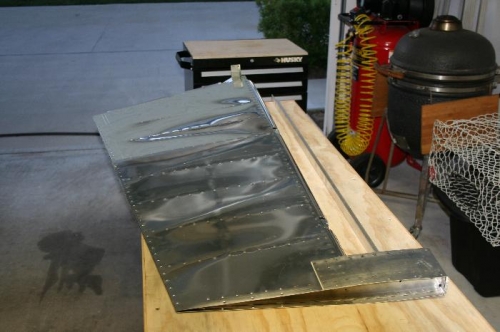

Riveted the Rudder skins to the Spar and Ribs.
Rolled the leading edge using 3/4" galvenized water pipe and installed rivets to hold the edges together.
