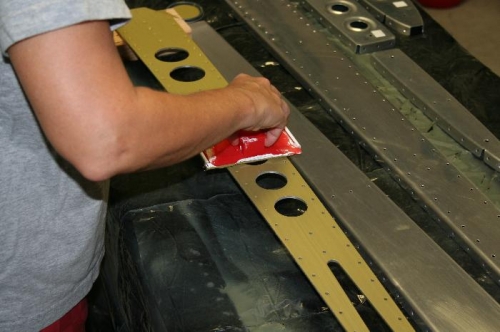

Disassembled the Vertical stabilizer.

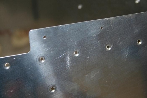

Deburred all holes, Dimpled the skin, ribs and spars.
Countersunk rivet holes on Rear Spar for flush rivets at the bottom.
Used Cortec system to prepare parts for priming and primed all ribs and spars.
Dimpled Skin
Using Cortec Corosion System
Cortec Primer
