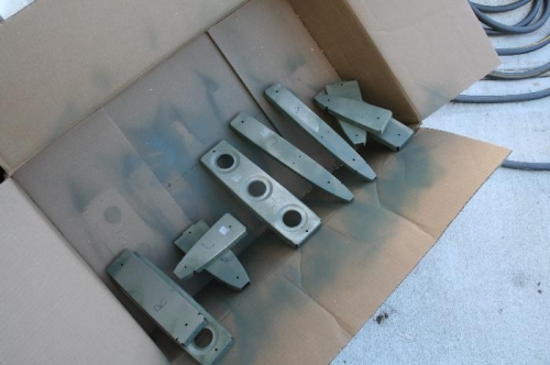

Primed the horizontal stab skeleton using self etchnig aluminum primer.
Primed the inside of hor stab skins where the skeleton touches.

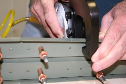

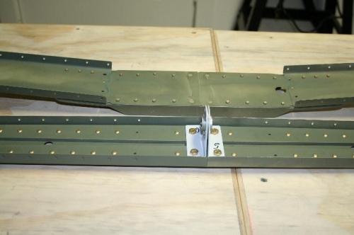

Riveted the HS-609PP bars to HS-603PP spar channels.
Rivetted all Elevator hinge brackets to rear spar.
Rivetted HS-710 & HS-714 to the front Horizontal stab spar.
Bolted HS-411PP center bearing to the spar and set proper torque.
