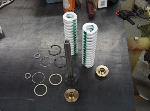

The struts are straight foward. I cleaned out the bore and the pistons with a can of breake and parts cleaner. Then I wiped the bore clean. Next step I coverd the seals with a light coat of white grease and installed. I wiped a thin coat of white grease in the ramp of the bore. After that I put a Light coat of ATF inside of the bore. Then assembled per plans. I am waiting on some parts from Avipro. My rodends should be in that order.
Cleaned parts

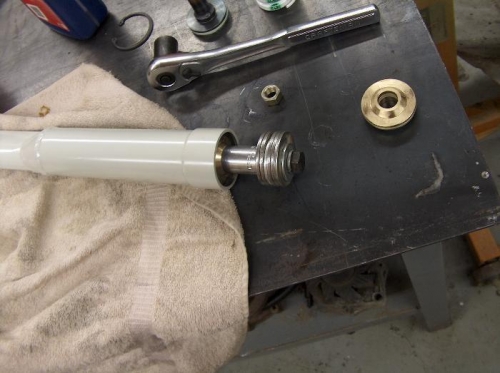

My bolt was a little long it was the first one I put my hands on it needed a few washers
