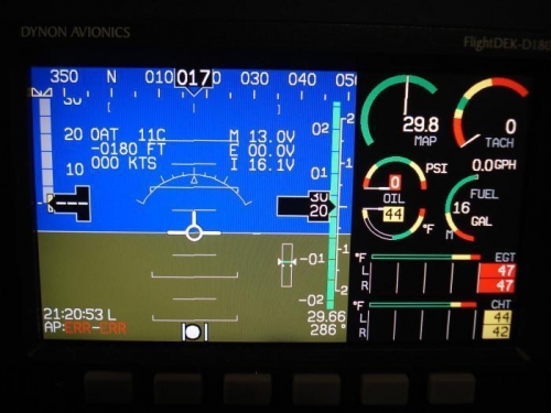

Brief Description:  Replaced the FT-60 sensor.
Flew a lesson this morning on holding patterns with Bob Sob. Then moved the airplane down to the maintenance hangar. Tracy Green was there and was pressed into service as my tool man. I sat in the plane and removed the tunnel cover and changed out the FT-60. Dan Dorsch and friend Dick flew in from Rochester to check out my plane. They are building a '12 - working on the fuselage.
Completed the swap out of the sensor and ran the fuel pump, which showed fuel flow on the Dynon. Success!
Hooked up the battery charger to top off the aircraft battery and left the Master and Avionics switches and Dynon turned on to top off the Dynon internal battery.
Bad FT-60.
Bad FT-60.
