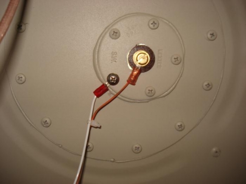

Put a 100 ohm resister across the fuel sensor wire to airframe ground. The Dynon read out a new number, rather than the constant 500 of yesterday. That narrowed the problem down to the tank ground or the sensor itself. Added a ground wire from one of the mounting screws to the tank mounting bolt down in the left hand corner. Problem solved! Van's needs to incorporate this ground wire into the plans. I'll suggest it.

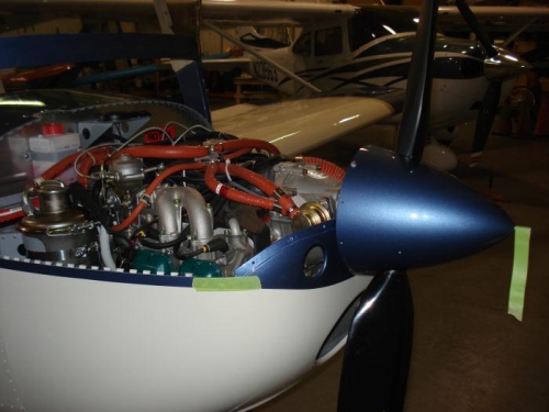

Removed the top cowl, disconnected the CarbMate, installed the pitot tube, and began installing the spinner, all in prep for the inspection.
Fuel tank ground.
Spinner and pitot.
