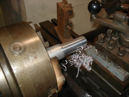

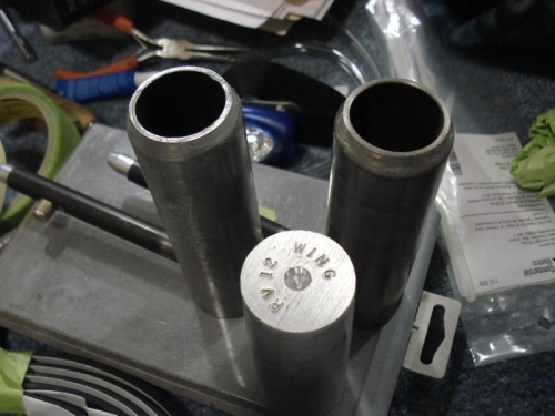

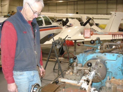

Anyway the piece of pipe I had bought was not thick enough. Bill found a piece of 2" solid aluminum rod and we decided to make our own tapered pin (bullet) as a test run of the new old lathe that Bill recently acquired. An hour later we had a perfect bullet, that worked flawlessly to align the spars. In 2 minutes both pins were in where they should be.

Bill working the lathe.
Turning down the bullet.
Two wing pins and the new tool.
