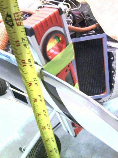

Got to the airport pretty early. Cut a piece of aluminum angle the width of the new digital level and taped it to the level. Ran a band of tape around the lower part of the level so the level contacts the back side of the prop at top and bottom. Seems to work quite well and be repeatable. Set the blades to mid range and equalized the two blades. Torqued to specs.

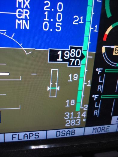

Performed the trim calibration procedures from the Dynon manual. Set the T/O mark to 1/3 of the range.

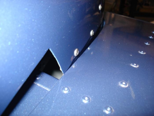

Installed tail cone, both halves. Fit is good except two screws on each side protrude enough to bind on the stabilator as it goes up and down, and the fiberglass itself catches in one spot (see picture.) I'm considering options to correct.

Blade angle setup.
Blade angle setup.
Tailcone binding on stabilator.
Trim indicator takeoff position.
