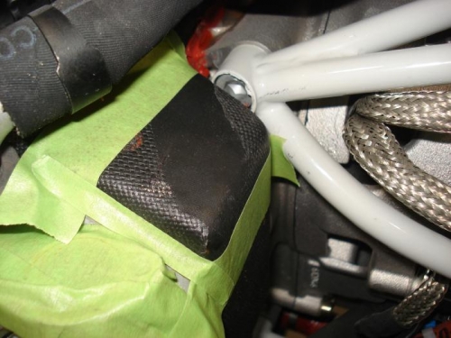

Cut out the diagram of the hole for the gascolator screw hole access and crawled under the plane to mark for the drilling. The template was not to scale - too small. Later at home I discovered the reason for that and made a new 100% to scale template.
Removed the left carburetor and associated stuff. Siphoned the coolant reservior into a coke bottle and removed the coolant hose that was in the way. Caught the residue of coolant with paper towels. At this point the left rear of the cooling shroud was clear for cutting.

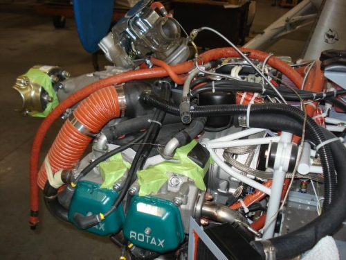

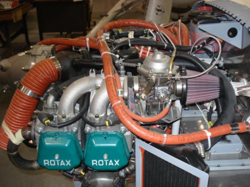

Before disassembly - for the record.
Carb peeled back, shroud exposed.
Area to be cut.
Area to be cut.
