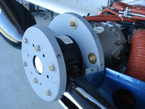

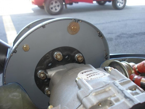

Completed balancing of prop.
Mastered operation of the euipment and obtained a good balance. IPS went from 1.2 before balance to .05 after balance. Engine operation in ground runups now noticably smoother through entire RPM range.
Rattle still there.
Final weight placement - front.
Final weight placement - rear.
