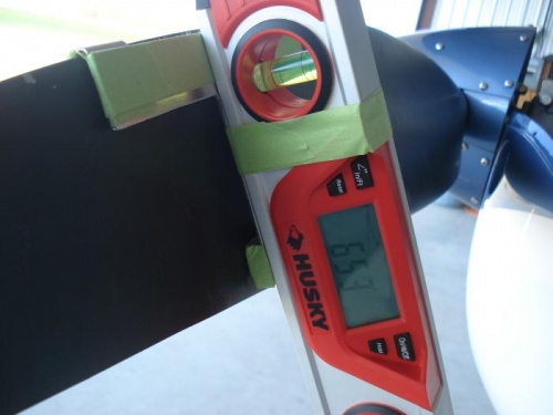

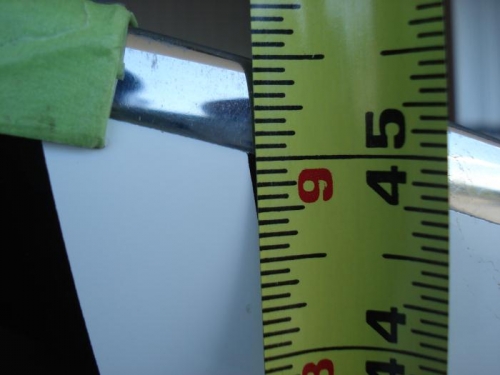

Checked prop pitch using my standard measuring technique. Found blades at 67.0 and 66.8.
Reset both blades to 66.0. Torqued mounting bolts to 20 ft/lbs and did a static runup. RPM's were down to 5140.
Reset both blades to 65.3. Torqued mounting bolts to 20 ft/lbs and did a static runup. RPM's were down to 4960. This is within the range recommended for WOT static runup. Replaced prop bolts one at a time and retorqued with Nord-Lock's. Reinstalled spinner.

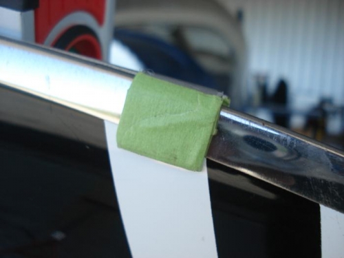

Pitch set up - height.
Pitch set up - fixture position.
Pitch set up - digital level.
