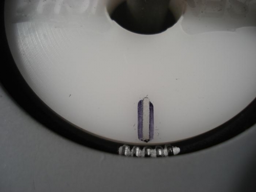

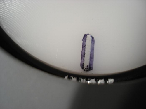

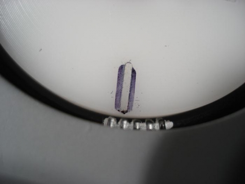

Reinstalled prop in cold hangar. 31F this morning. Set blades to w/i 0.1 degrees using digital level in fixture. Set towards the fine pitch limit which should give me a few more RPM at WOT.
Downloaded Dynon log from last flight. Put battery charger on to top off the A/C battery.
Fine pitch limit.
Fine pitch limit.
Coarse pitch limit.
Coarse pitch limit.
My setting.
My setting.
