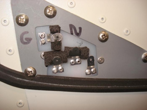

Brief Description:  Reworked wing contacts, built level bracket.
Removed pins and partially slid wings out. Added an extra rivet to prevent the contact base from flexing back away from the contacts. Bent contacts out and inserted foam behind them to hold them out. Dabbed some Noalox compound on the contacts to prevent corrosion. Smeared anti-seize paste on all the spar stubs, as instructed in the plans revision. I pushed the wings back into place and Bill helped me insert the pins. Tested all functions including stall warning OK.

Contacts bent, foamed, coated.

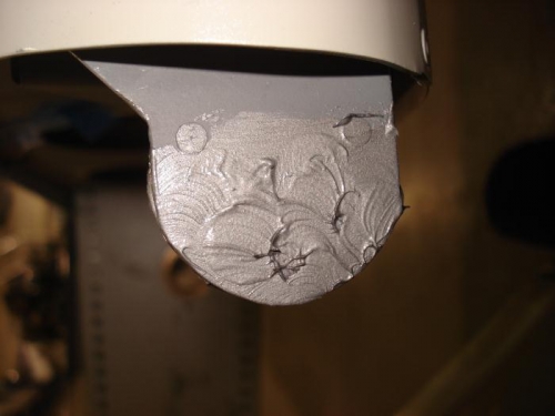

Stub spars with anti-seize paste.
