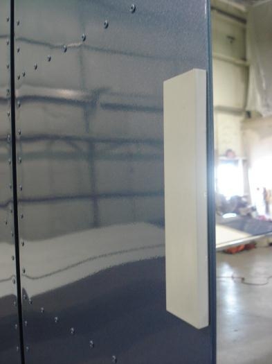

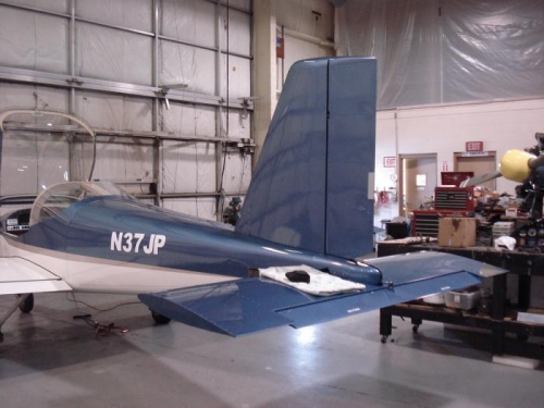

Removed temporary rudder trim tab and installed the Avery Wedge. Slightly squeezed right flaperon trailing edge. Adjusted canopy latch to reduce latching force.

Wedge installed.
Wedge installed.
Wedge up close.
Wedge up close.
