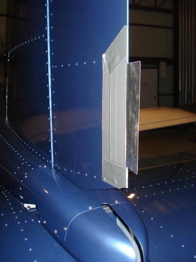

I fabricated a temporary rudder trim tab out of a piece of scrap aluminum. Took it down to the T hangar and duct taped it to the rudder, left side, so as to apply right rudder. Test flew, ball is centered, while holding left aileron to counteract heavy right wing.

Landed, VERY gently squeezed the right flaperon trailing edge. Flew again. This time roll and yaw both in almost perfect trim. I'll go with that for now, check again after wheel pants are installed. I'll order the Avery Tools rudder wedge to replace the temporary trim tab.

Temporary rudder trim.
