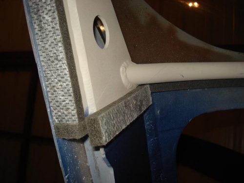

In the afternoon I went to ACE and purchased a variety of weather stripping products. Came back to the hangar and installed a thick foam strip around the bottom of the canopy sides. Fits nicely and makes a huge difference.

3/4' by 3/4
3/4' by 3/4" foam weather stripping.
