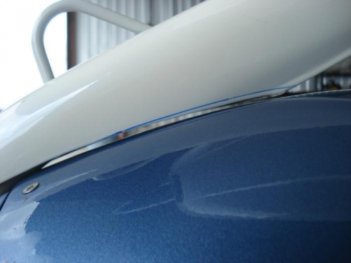

Noted slight rubbing between the nose gear strut and the top of the wheel pant at aft most position. Marked for trimming - see photo. Also some interference noted at forward position. Removed nose wheel pant.

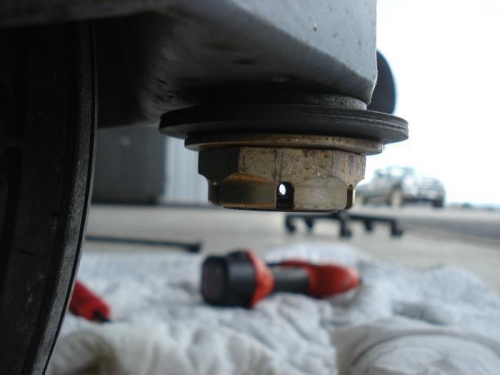

Noted, as on previous flights, a stiffness in the castoring nosewheel rotation requiring excessive use of brakes to make turns. Removed cotter pin and backed off the 1 1/2 inch nut by one flat. Reinstalled pin, test taxied and went once around the pattern including a cross-wind landing. Steering much easier.
Strut fairing marked for trimming.
Tension adjusting nut, pin removed.
