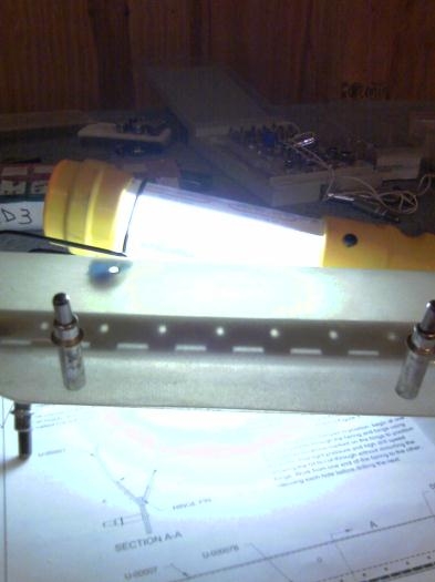

Finished nose leg fairing. Used my own alternate method of drilling the hinges and fairing. Drilled the hinges first, then back lighted. Much easier than tying to see those pen marks through the fiberglass.
Managed to squeeze one of the hinge loops while setting rivets. Was able to force pin in but it is too tight. Will have to try and get a long drill at the hardware store to ream it out.

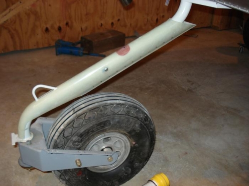

Match drilling nose leg fairing.
Fairing installed with RTV blob.

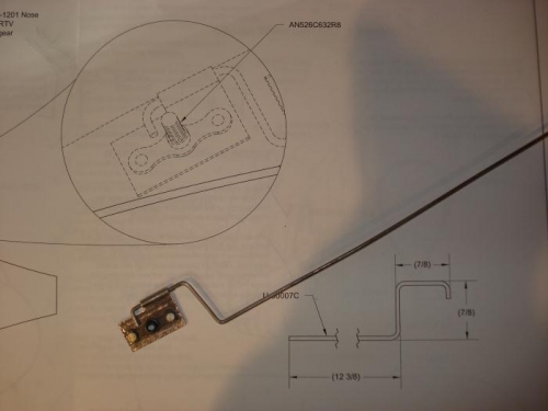

Retainer pin and clip.
