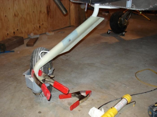

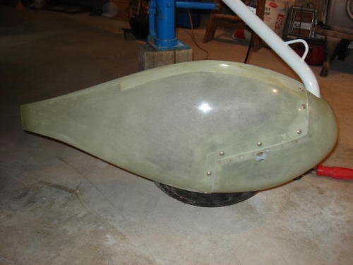

Another long day in the shop. I feel like I've gone back to a regular job - except there is no paycheck! Sanded off the flox mixture I had used to fill some of the big pinholes in the fiberglass parts. Then resumed work on the nose pant. When test mounted I found that the clearance to the tire was way too tight, and clearance to the nose wheel arm was also too close. Marked the parts and removed and trimmed. Looks like I picked the wrong set of the double scribe lines to cut to originally.
Pretty much finished the wheel pant, started on the nose leg fairing.
Nose pant test mounted.
Marked for tire clearance.
Fitting the nose leg fairing.
