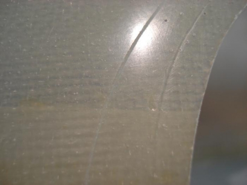

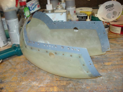

Brief Description:  Worked the nose pant.
Began the day working on getting a good fit between the nose pant halves. What a drag! Took me HOURS and it still isn't perfect. The bottom of the rear portion had two sets of scribe lines. See photo 1. I used the outer ones and that seems to be the proper one.

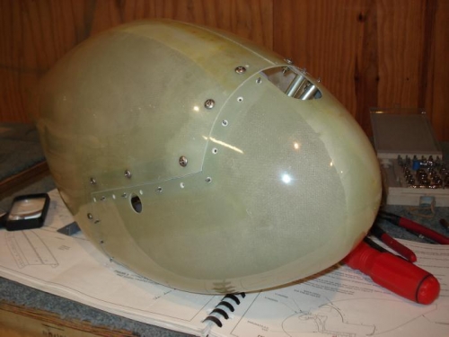

Ended the day (evening session) by epoxying and riveting in the splice strip. Tired.
