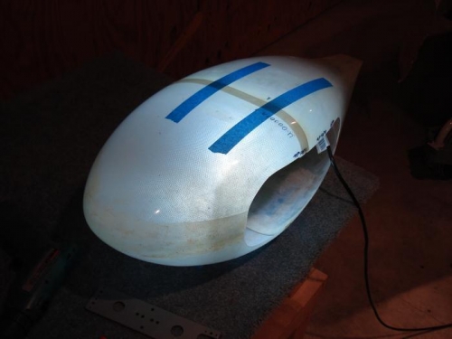

Went to the shop and continued working on the left main wheel pant. Fitted the two halves. One of the things you are told to do is to put a strong light inside to facilitate lining up the metal Wheel Fairing Bracket with the dimples in the fiberglass. With the light inside, the fibergalass lights up like a big glowing orb! I just had to get a picture of that! Went as far as I could with the left pant until I needed to jack up the wheel.

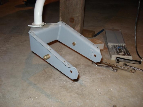

Since I had just ordered the towbar I jumped ahead and jacked up the nose wheel andi nstalled the bolts and washers where the towbar connects. Also installed the nutplates on the flanges.

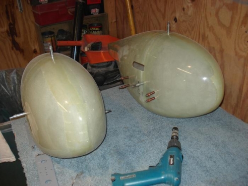

Worked the right pant to the same point as the left. Trimmed the nose pant halves with the Dremel and sandpaper.
Glowing wheel pant!
Glowing wheel pant!
Nose fork with towbar studs & nutplates.
Main pants fitted.
Main pants fitted.
