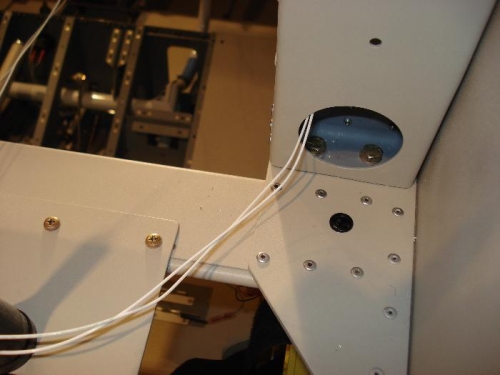

In order to get ready for starting the FWF wiring, I got out the "care package" that came with the new starter relay bracket. Apparently the mounting bolt spacing changed somewhere along the way. Prepped and primed the bracket. I want to be ready to work on wiring when George and Pip visit on Thursday.
Spent a long time trying to find the stock for the battery mount spacers. Can't find it. Will try to get locally.
Mounted the cockpit eyeball light. Carolyn helped me fish the wires through the roll bar. Ran into a problem where the plans say to make the 3/8" hole for the wires. Plans say to drill up from the bottom, and that's not possible since the ELT is already mounted.. Was able to drill it from the top at a slight angle and get the snap bushing in OK.
Cockpit light mounted.
Wiring exiting the roll bar.
