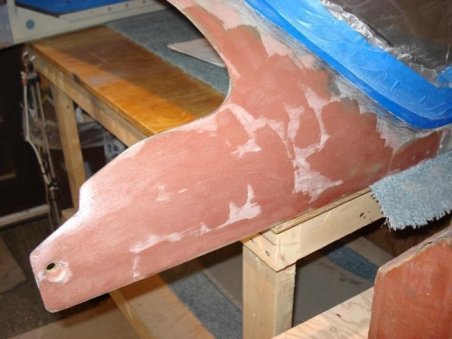

Sanded down the previous coat of filler on the canopy with 100 paper and filled low spots. This is getting REALLY repetitive! Cleaned out the mounting holes.

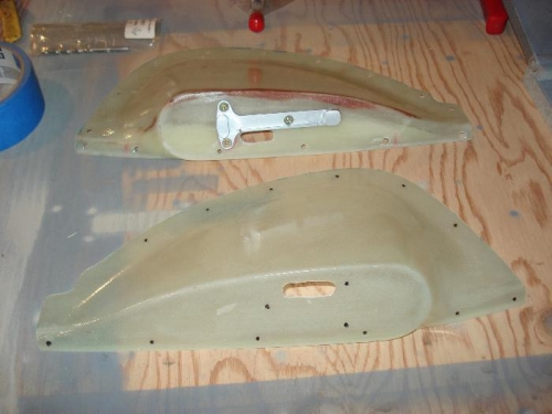

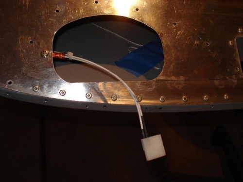

Worked on the right wing extension and some of the left wing parts. Trimmed the flox mixture and drilled out the holes. Sanded both extensions with 220 paper and coated with epoxy to fill pin holes. Built all the electrical connections and installed the molex connectors on both light fixtures. Used solder rather than crimping the pins.
Sanded and filled (again.)
Tip extensions sanded and epoxy coated.
Ready for the extension/light.
