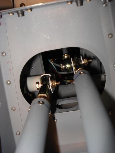

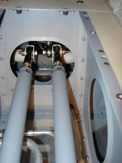

Last night there was a post on the VAF forum warning of interference between the bolts on the end of the flaperon push rods. See: http://www.vansairforce.com/community/showthread.php?t=57729.

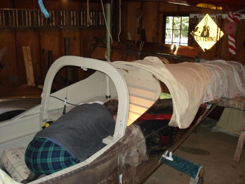

This resulted from not reversing the right flaperon bolt when the autopilot servo was installed. I pulled the baggage compartment tunnel cover, and it was immediately clear that I had the same problem. Called Dave up to the garage and he lent me his younger body to contort into the cockpit and swap the bolt. See photos.
New (correct) bolt orientation.
Right flaperon bolt wrong way.
Neighbor Dave in
Neighbor Dave in "the position."
