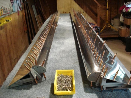

Brief Description:  Finished flaperons except for rivets.
Deburred the last two flaperon skins, and installed with clecos. Final drilled and hand riveted the few holes requiring that step. Inserted rivets wherever possible and now just awaiting the return of the pneumatic rivet puller.

Twin flaperons awaiting riveting.
