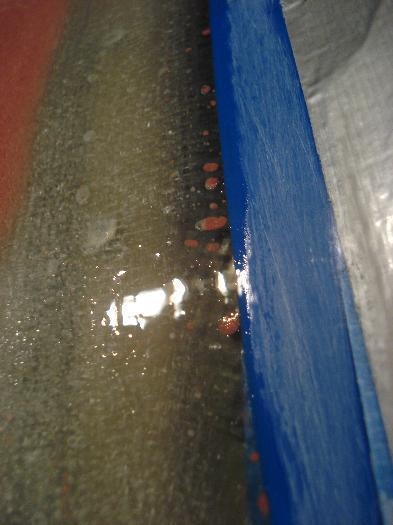

Started the day by sanding down the epoxy and filler laid down on Monday. Then pulled off the first layer of tape. I learned that I had not really gotten down close enough to the tape on the previous go-around, so Had to revert to 80 grit paper, then 120, then 150. This time I think I did it right. Mixed a 1/2 pump batch of epoxy and brushed a light coat up next to the tape, overlapping the tape only slightly.
Then mixed microballoons into remaining epoxy and used it to fill a few more low spots. Ended by smearing filler on the low sides where the fiberglass transitions into the metal, covering the flush rivet heads. Thought about this for quite a while. Don't know if this was a good idea or not, but I can always sand it off if I don't like it. Made the rough openings for the pivot bolts, enough to get a socket on the bolt. I will sand it smooth after the canopy comes off.

Final (I hope) coat of epoxy.
