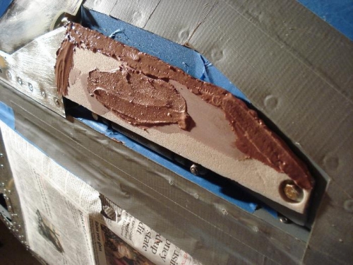

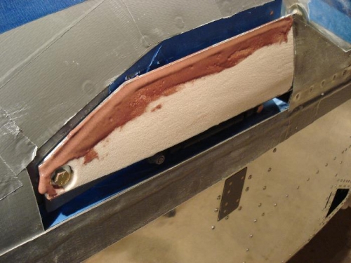

Sanded down both foam blocks to contour of fuselage. Right side still has a depression where the filler sagged. Filled the depression with more microballoon filler. The instructions say to cut a 1/8" "shelf" along the top of the foam blocks and fill it with epoxy and flox. I don't see why this is necessary, but I followed the instructions. I already had a batch of epoxy with micro balloons mixed so I used that for the filler. Next session I will sand all this out.

"Shelf"
Shelf and repair part 2.
