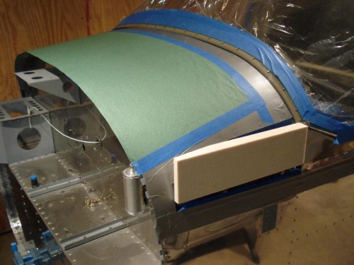

Brief Description:  Started on fiberglass fairing.
In the morning I had a meeting, then worked in the shop for a while. Ground down the weld that was interfering with the top of the canopy coming all the way down. Removed the inside handle and ground off the weld on that where it was hitting the latch plate. Bent the latch plate forward a little. Latch now works pretty well, except it is hard to unlatch. Hopefully it will loosen up with use.
Went to a business meeting with my cousin, then returned to the shop. Put away all the tools and cleaned the shop. Got out the foam blocks and shaped them.
Starting to fit foam strips.
